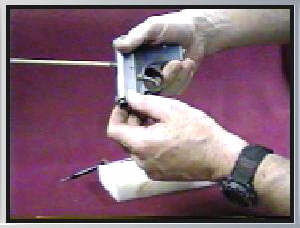

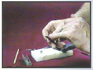

Here we see the use of a simple ordinary chopstick, as a device to hold open the slide while removing cross pin. Other methods have been used using custom made ''stop-sticks'' - but it really does not matter too much as long as what is used has the desired result!
Overall hopefully the commentary within the clip explains what is going on.

This process is certainly the hardest part of dealing with the gun - equally it is harder to portray well with video. I make use here of my reasonable hand strength, to hold open the slide for short spells while carrying out insertion of the pin - other methods may need devised by some.
The insertion of the recoil assembly is another stage where sometimes the use of channel lock pliers may be needed. To marginally facilitate my method shown, I suggest a simple smoothing process.
